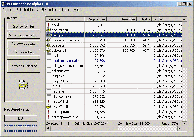

The Main Window
The main window has a list view that contains the current batch of files.
![](02gui.5.png)
Right clicking anywhere in the files list cause a popup menu to appear
that duplicates much of the functionality of the buttons on the left. In
addition, it contains the 'Remove' action that removes all selected items
from the list. Items may also be removed by pressing the DELETE key when
desired items are selected.
![](02gui.4.png)

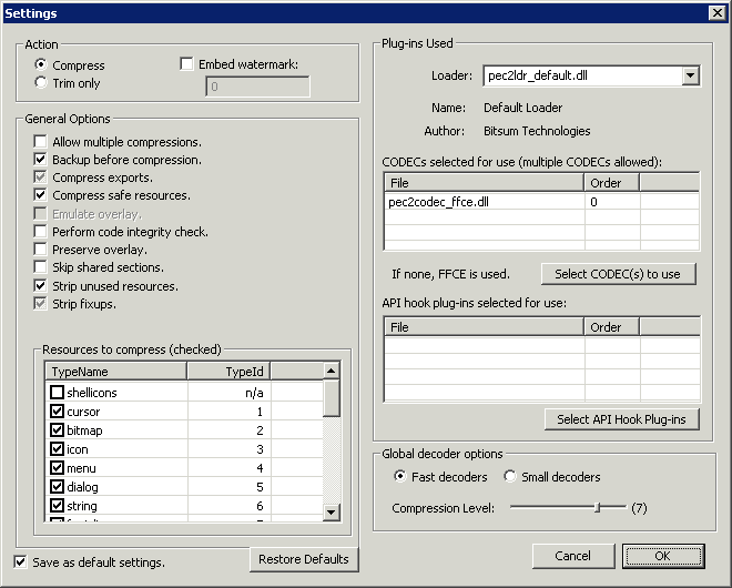

The Settings Window
Each item in the listview can have individual settings. Therefore, one
must be aware that when they choose to modify the settings, they are doing
so for the item(s) that are currently selected.
![](02gui.2.png)
When an checkbox is checked and grayed, it means that PECompact2 should
automatically determine the appropriate settings based on the file it is
compressing.
Actions:
Compress modules with PECompact2.
Simply trim and realign modules.
Must be used in combination with trim or compress. See PEWatermark.exe console mode
application for more functionality.
This option causes a watermark to be embedded into the module.
This watermark can later be retrieved for identification of the
executable. The watermark is meant to persist through modifications to
the module. |
Documentation of configuration options is
here.
Checkbox Settings
Automatic = Yes or No = Gray and checked.
On = Yes = Checked.
Off = No = Unchecked.

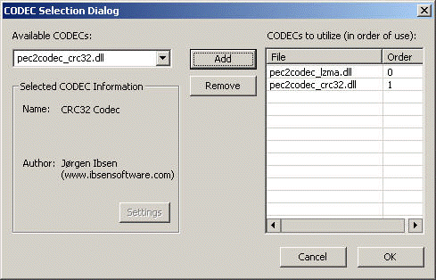

The CODEC
Selection Dialog
The CODEC Selection Dialog allows for
specification of which CODECs should be used on
the target file(s) and in what order they should be used.
![](02gui.8.png)
In the above example, files will be compressed with LZMA, then have a
CRC32 test performed on them. At runtime, the decoding order is reversed so
that the CRC32 check is performed, then the data is decompressed by LZMA.
See the CODEC plug-ins page for more
information on the available CODECs.
Ordering is very important because it can affect compressibility and/or
the desired output. See the CODEC
Ordering section of the CODEC plug-ins page
for more information.

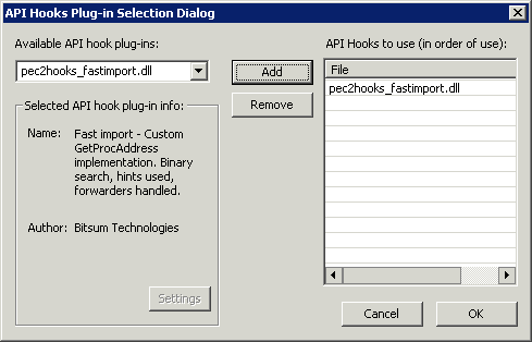

API Hook
Plug-in Selection Dialog
The API Hook Plug-in Selection Dialog allows for configuration of which
API Hook Plug-ins should be attached to
compressed modules. Any number of API Hook plug-ins may be used on a single
compressed module.
![](02gui.3.png)
